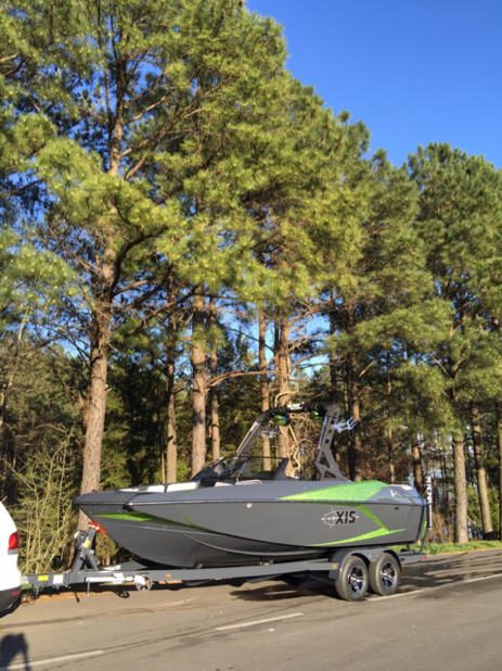

So the new 1.72:1 gear ratio with the 2313 prop is awesome. Took out the T23 and filled everything up. About 2,900lbs plus the wedge down and it planed off with out struggling at all. Wake looked huge, it was too cold to ride though. Pretty pumped on having more torque this year.

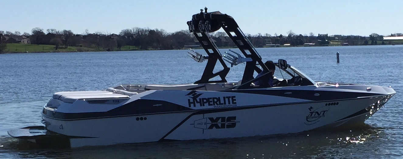

Ran the 2313 on my 350 2015 A22 yesterday. It has no issues planing, but it's too low of a pitch for me for regular use. I'm probably going to swap it for a 2249. Top speed on a 2313 is 31mph. 2249 should get me closer to 38mph.
Regardless, had a great day breaking it in and love the new changes to the 2015.
