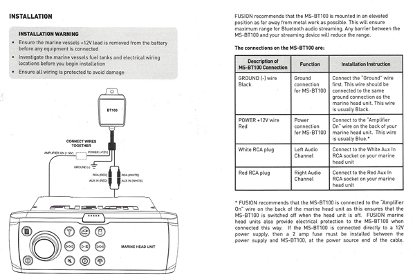

I am running the Sony head unit from factory.
Black wire from Bluetooth to black wire. (Ground)
Red wire from Bluetooth to Blue wire from head unit. (Power)
Plug the two RCA jacks to the AUX jacks from head unit and you are done.
Hope this helps.

ok, Ill reply to myself in case someone else is interested. There is a corded dual AV input that enters the head deck in the top left corner just beside the sub out. Connect this then all you have to do is source some power for the module. I wired mine to the ACC switch so you dont have to re-connect if you stop the engine from running. Crimp a spade connector for the power to insert onto one of the open prongs on the ACC switch and wire the neg into the neg for the head deck. Whole process takes maybe an hour and works perfect from over 50' away. Highly recommend. In the end you can run sat radio and bluetooth if you have the right modules.
