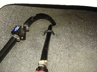

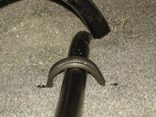

Walter- I rerouted my front pnp bag today and took it out to test it, works a lot better now. That little air pocket under the chillax seats gets filled to the top now that i switched the vent line. I also cut the fiberglass where the vent enters into the space behind the kick panel. In my boat the vent hole they cut was all the way to the lowest point on the floor under the chillax seats, so I cut the hole 1" wide all the way up (6" or so) so that the vent line cant get kinked or pinched. I hope they do not put that hole that low on every boat because that is poor execution.
Everybody- 2 things. First, I know a cheap "free" way to keep the chillax brackets from puncturing your front sack. Mouse pads. You know the typical one thats rubber and neoprene like a wetsuit. they are perfect thickness. I am going to "re-appropriate" our mouse pad, cut it into 4x4 squares, fill up the front sack, then glue them on the sack under each bracket (4 on my 2011). I think you can buy em real cheap online, I just found a bunch for 99 cents and free shipping. Second, I added a rubber protected metal strap to hold the front pnp sack drain line nice and low against the floor as it comes up out of the hole. I noticed that the hose cant make that sharp turn and ends up 6-7" off the floor before it enters the sack. when idling or sitting and draining it would not drain the sack all the way. when I would get up to speed and hit "empty" it would drain a lot more water. check out the pictures, it really keeps that drain line low against the floor.
File comment: Close up of drain hose and strap.
File comment: This is shot from the bow, look towards the back of the boat with the chillax seats up. you can see the fill hose coming out as well as the drain hose. I put that strap as close to the holes as possible.

Gibby, thats the front drain strap i put on the front pnp. hope that fixes his problem
Did this last night in my boat.
Thanks Johnny!
