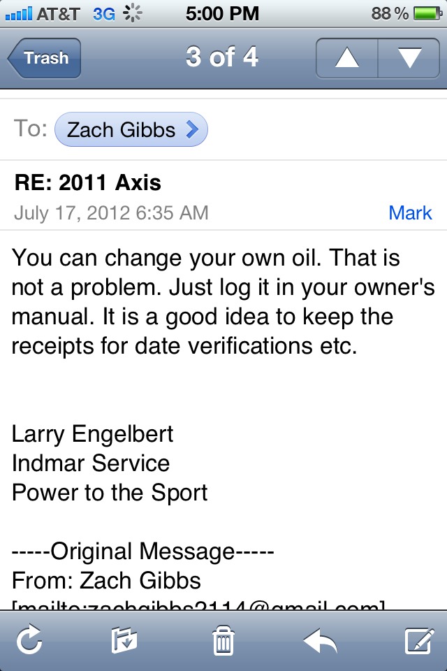

Don't you have to let the a certified Axis dealer do the maintenance in order to satisfy the Indmar warranty?
don't think so

I emailed Indmar about the warranty when doing your own oil change.

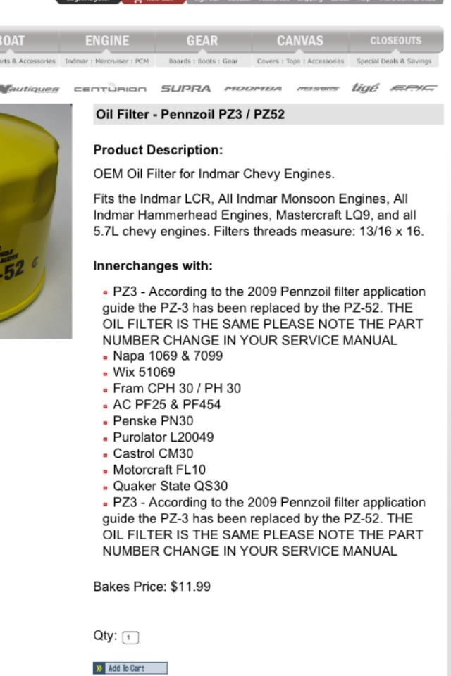

Here's a list of compatible replacements for the filter. Much cheaper at an autoparts store than bakes online.
