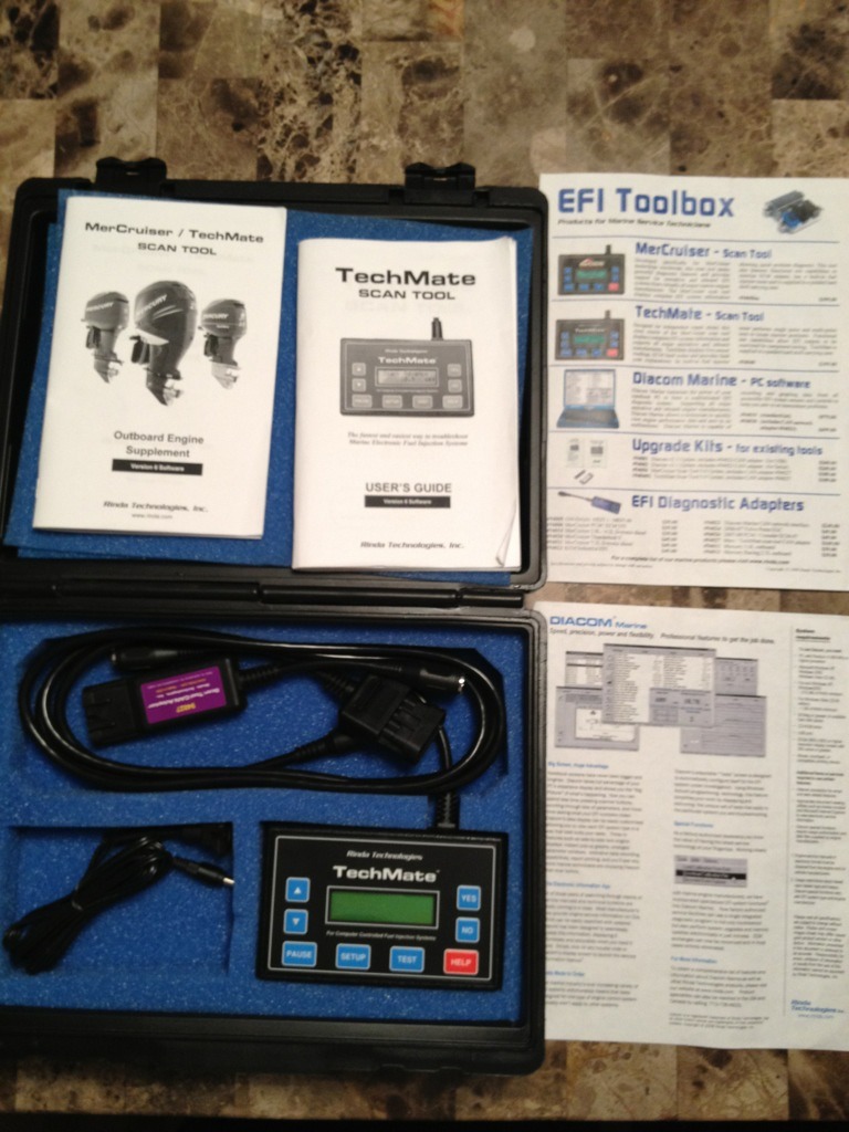

I used the handheld tech mate from Rinda technologies, you can pick one up for about 515$, it works on a bunch of different boats and engines

Is it just an obd2 connector? and do they use a gm ECM?
 Post subject: service required!!!......?
PostPosted: Fri Jun 29, 2012 7:42 am
Yes it's a GM computer that comes on the crate engines, probably has a custom program for marine use, axis boats use a CAN network interface, older boats use the regular OBD2 system but they both have special harness connectors which are different from standard car and truck DLC's

Thanks for the info, I was hoping to be able to access it with my laptup and tuning software.
