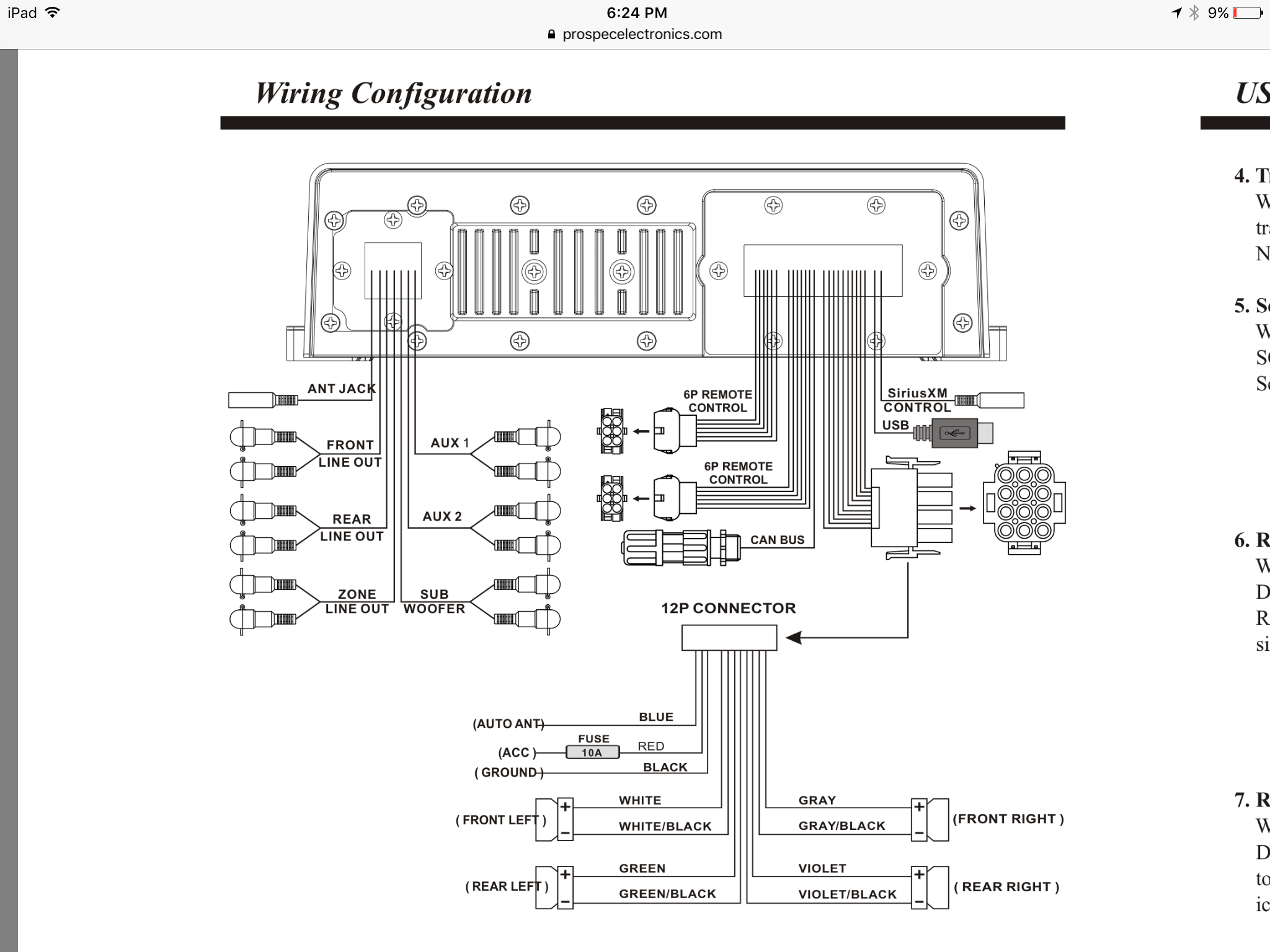

Any idea which wire in this diagram is the remote wire for turning the amps on?
 Post subject: Re: New 2017 A20 purchase
PostPosted: Wed Oct 11, 2017 5:00 pm
Posts: 480
Blue wire (auto ant)
