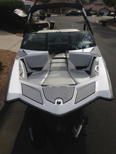

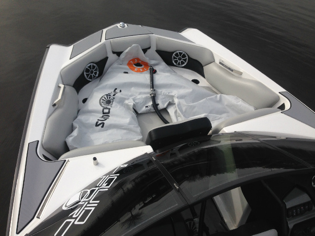

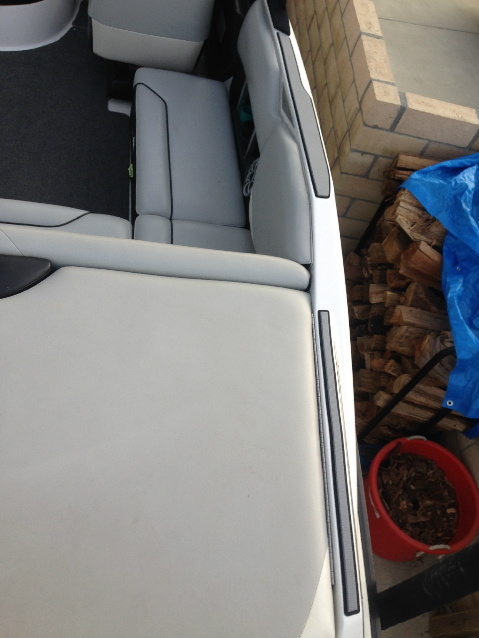

I did it finally!!!
 Post subject: Re: Gatorstep or Decadence Flooring?
PostPosted: Fri Dec 11, 2015 9:38 pm
It took a few hours to do it, mainly because getting all the residual glue from the deck track off was very difficult and time consuming. But once the surface was clean, it only took me about 10 minutes to put on all 9 pieces. I tried no heat, light heat with my gun, and high heat with my gun when peeling the deck track off, but all three methods left me with a glue footprint. It took a lot of acetone and scrubbing with a rag, and a little bit of scrapping to get it all off.
I went with sea deck because I was told a few years ago by my dealer that the swim step pad on my boat was Seadeck. I had that pad replaced twice under warranty due to incorrect installation, both times I was told it was a sea deck pad. Fast forward to this summer and I started looking into all the different companies. I called sea deck and they said they do not or have not done Axis boats, so my swim step is not theirs. I got their samples a few days later and their 6mm embossed "storm grey" is an exact match for my swim pad. exact. So i ordered through them, they already had my whole boat lay out, so I just picked the pieces I wanted from their order form. They came in a flat box a week and a half later. I thought about waiting til summer to instal so I could lay the pieces out in the sun over a barrel or something to get the curve I need, but I ended up just masking-tape them into a shape and sat them by the fire the night before. The problem with my swim pad was it was sent rolled up, and rolled the wrong way. The tech at the dealer did not lay it out in the sun over a barrel to get the correct curve to it before he installed it.... apparently the factory failed to do this as well. Needless to say, within a few days the corners were peeling up, again. So the 2nd time I brought in my swim step I made sure the service manager did the install, and he did it correctly with no issues. On my new sea deck pieces I noticed that the ends were rolling up just a little bit, even though they were shipped in a flat box... so I made sure to get a new curve to it before I installed it. Turned out great, matches my swim step perfect, and feels so much better on your feet.
