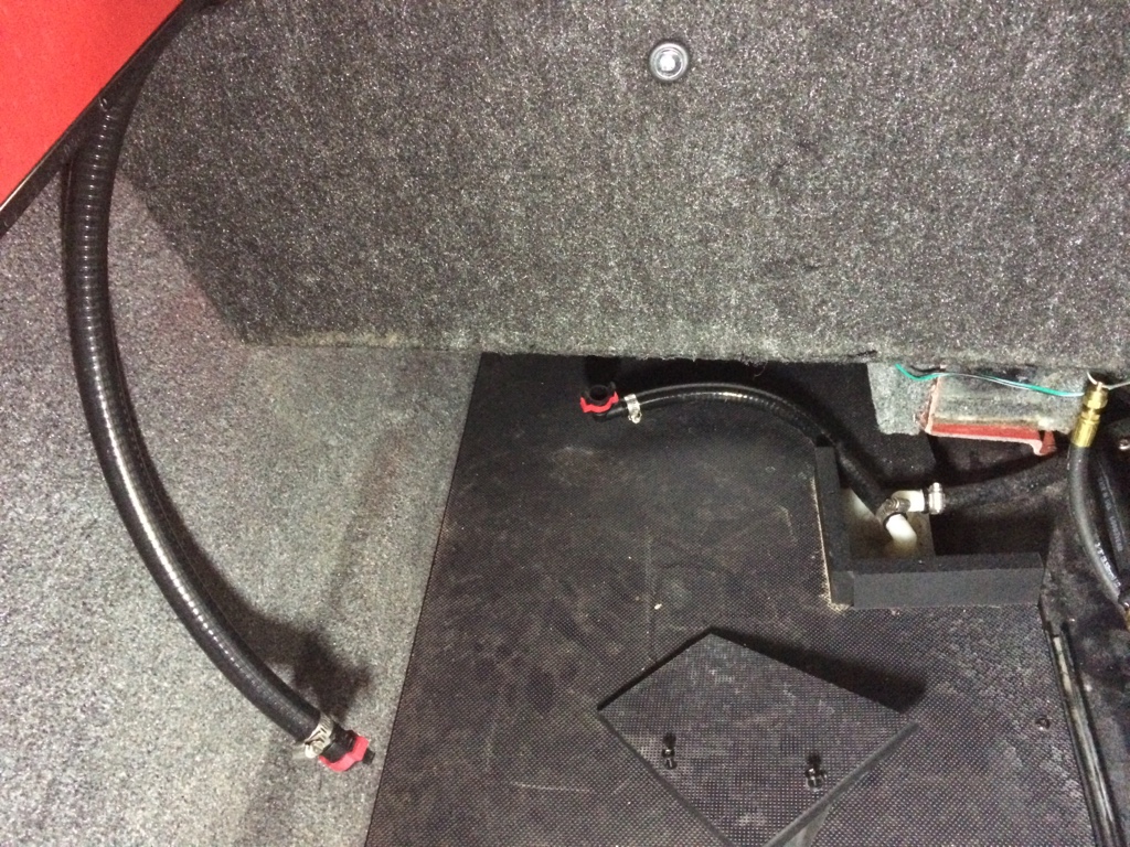

 Post subject: Re: 2012 axis a22 no plug and play?
PostPosted: Wed Apr 22, 2015 12:09 pm
Do you have the two U joints in the rear locker where the hoses are connected?
If you have hoses laid out under the front cushion that should mean that the front PnP was installed at the factory.
I don't think you have capped hoses laying in the rear of the boat??? 2012 is a long time ago. hard for me to remember exactly how they came in 2012.

ya i have the U connectors in the rear. 2 on each side. and i have the hoses up front so i think i do have PNP just doesn't have hoses laying in the rear lockers like the newer PnP does on the axis. think i was confused looking at the pNP setup of the newer axis boats.

Coversjim....
If some 2012 guys can chime in....
Sounds to me like you have the PnP installed. you just need to buy the bags and the fitting setup. We sell the bag kits for the 2012 at boardstop with the fittings. you will just need to buy some stainless steel worm clamps from the hardware store. We sell the clamps also but they are just a better deal at the hardware store.
You need to re-route the rear hoses to the bags.
unless someone at the factory screwed up and they just put in PnP in the front I think you are set.

I was changing my impeller and took this picture for you. I unscrewed the cover over tank openings so you can see my pnp. '12 A22.
PostPosted: Thu Apr 23, 2015 8:16 pm
you da bomb. How was the impeller changout? Mine was easier than everyone claimed it to be.
