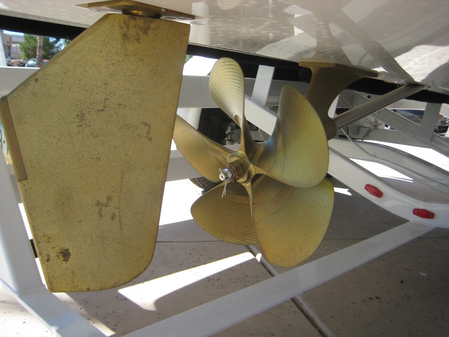

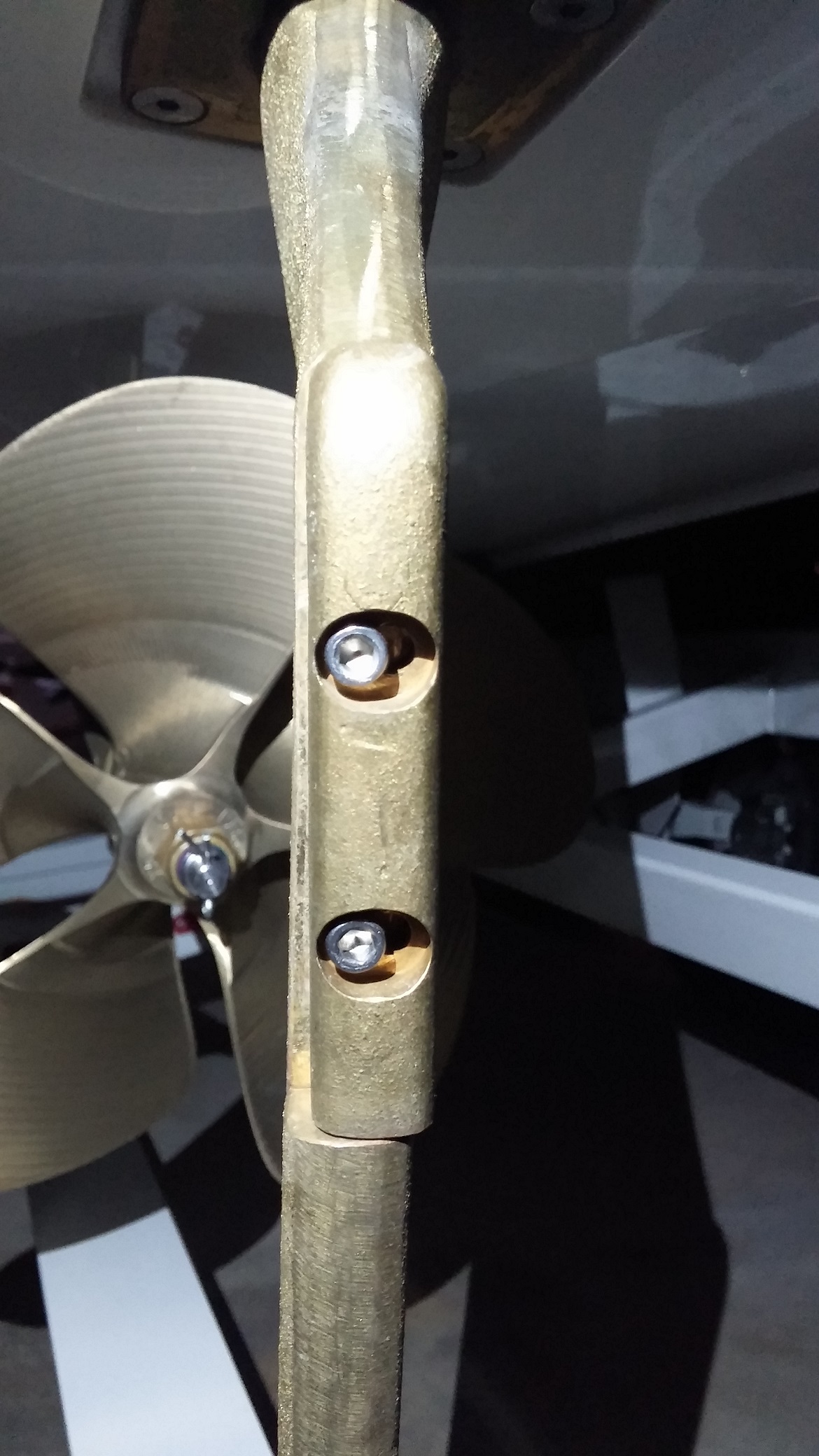

Can you post some pictures of the rudder and fiberglass around the rudder?

Heres some pics I already had on file.
Pic of the rudder tab is show how far it will go. I thought about making the holes longer so they could adjust further. Any ideas?

If the wheel rotates freely out of water easily both ways, then I would look at your prop. It doesn't appear like your rudder has had previous damage.
