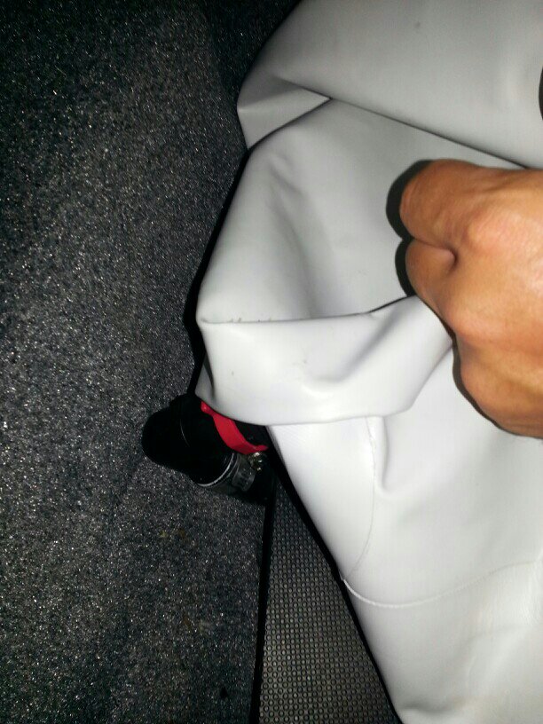

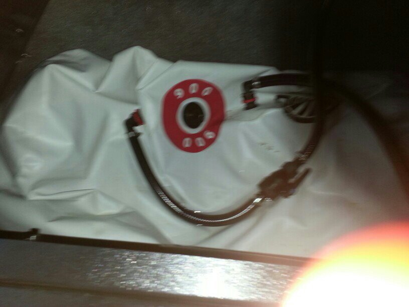

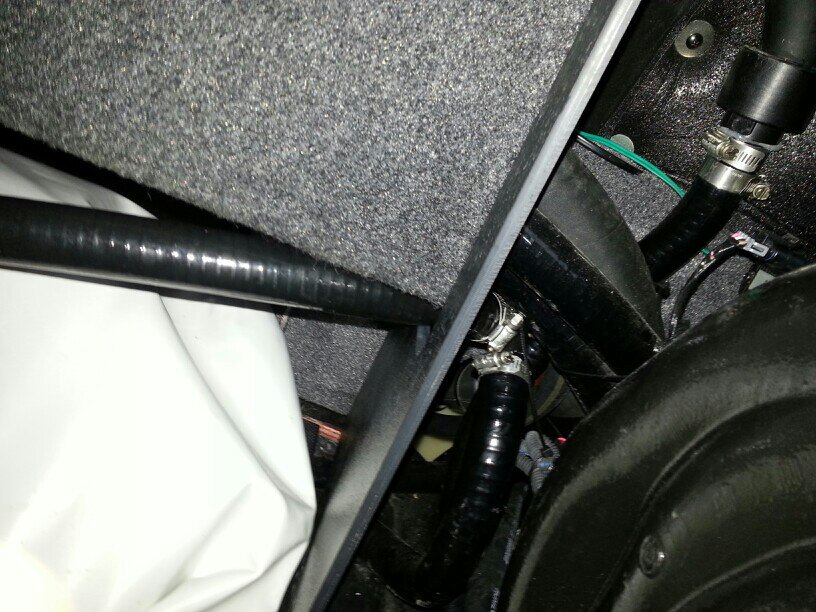

Regarding your rear hose. I see that you chose to re-route the hose out of the back of the hump. Don't you think that's going to cause the bag to not fully empty due to the elevation of the hump? All water below the level of the hump (and as such the fitting) wouldn't drain. Right? Maybe it would if you got the boat on plane?

I did the same and mine drains through the front pretty well. I have about 1-2inches of water left in the bottom of the bag.

boardjnky4 wrote:
Dezul,
Exactly what mcmiller said. It was the easiest way to do it so that the drain hose won't kink up. It has worked perfect so far. Not a single issue out of it. My dealer even complimented me on the idea.
