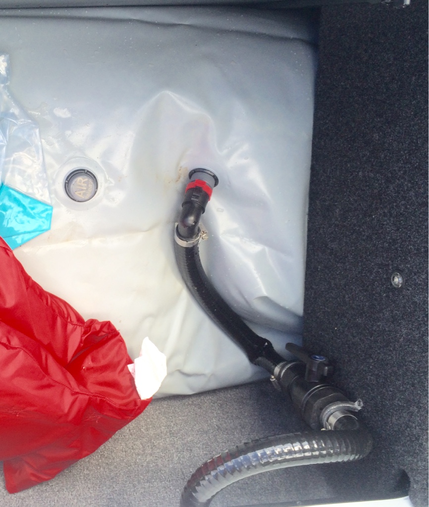

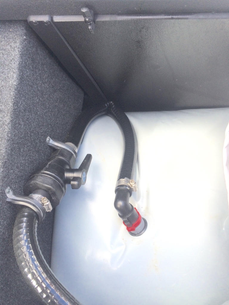

Thanks for the feedback. Had the 2014 out this weekend and snapped some photos of the rear bags pretty much full. Do yalls hoses look pinched like mine? I can only imagine that 900 or 1100 kinking would be far worse. The pump on the port side is mounted perpendicular to the hull whereas the pump on the starboard side is mounted parallel to the hull (see pics)- is this normal?

Take the straps off that hose and allow it to just sit loosely in the locker. Kink problem solved. Those handles are not the pumps. They are a shut off valve for your plug and play.
