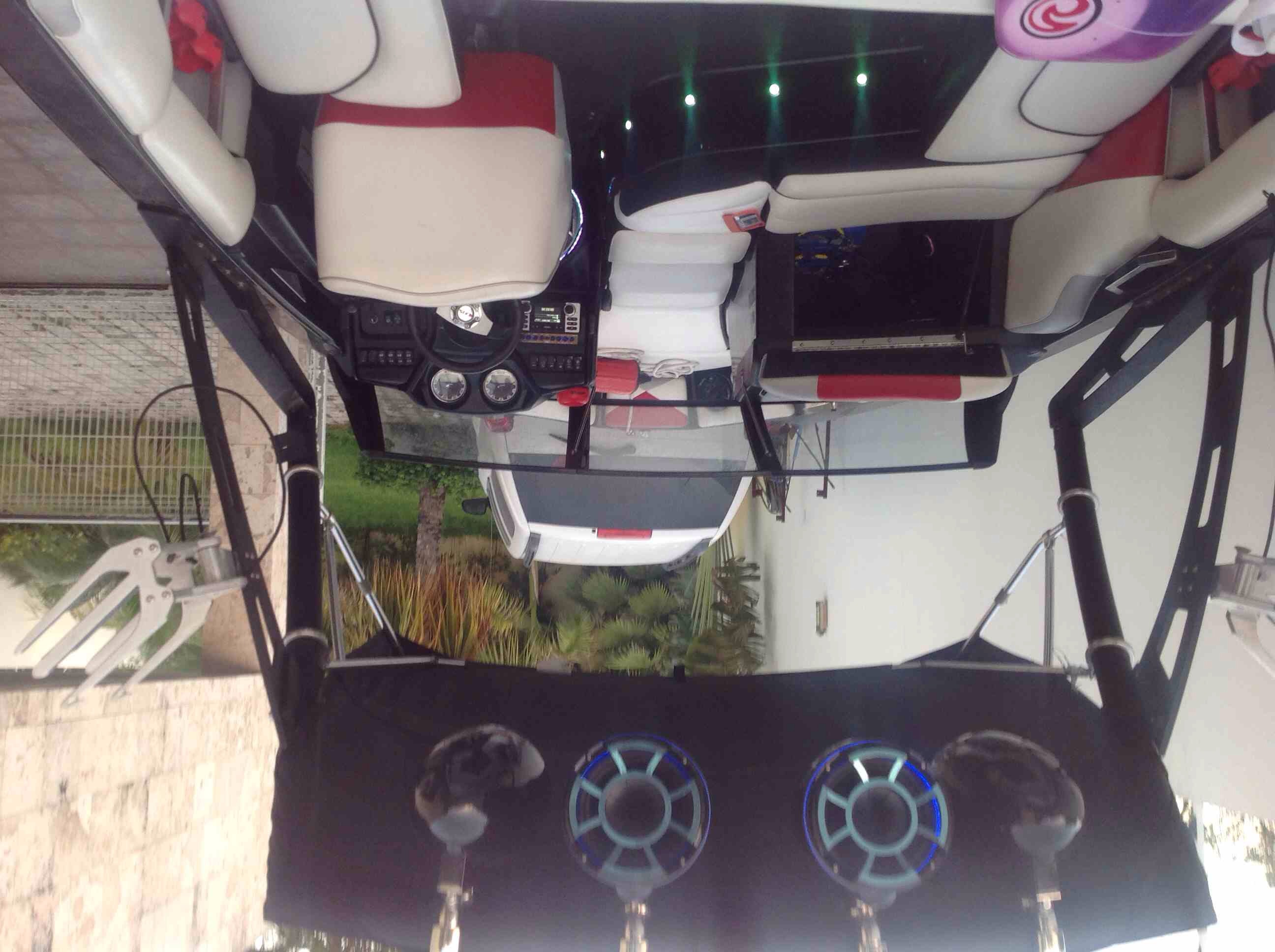

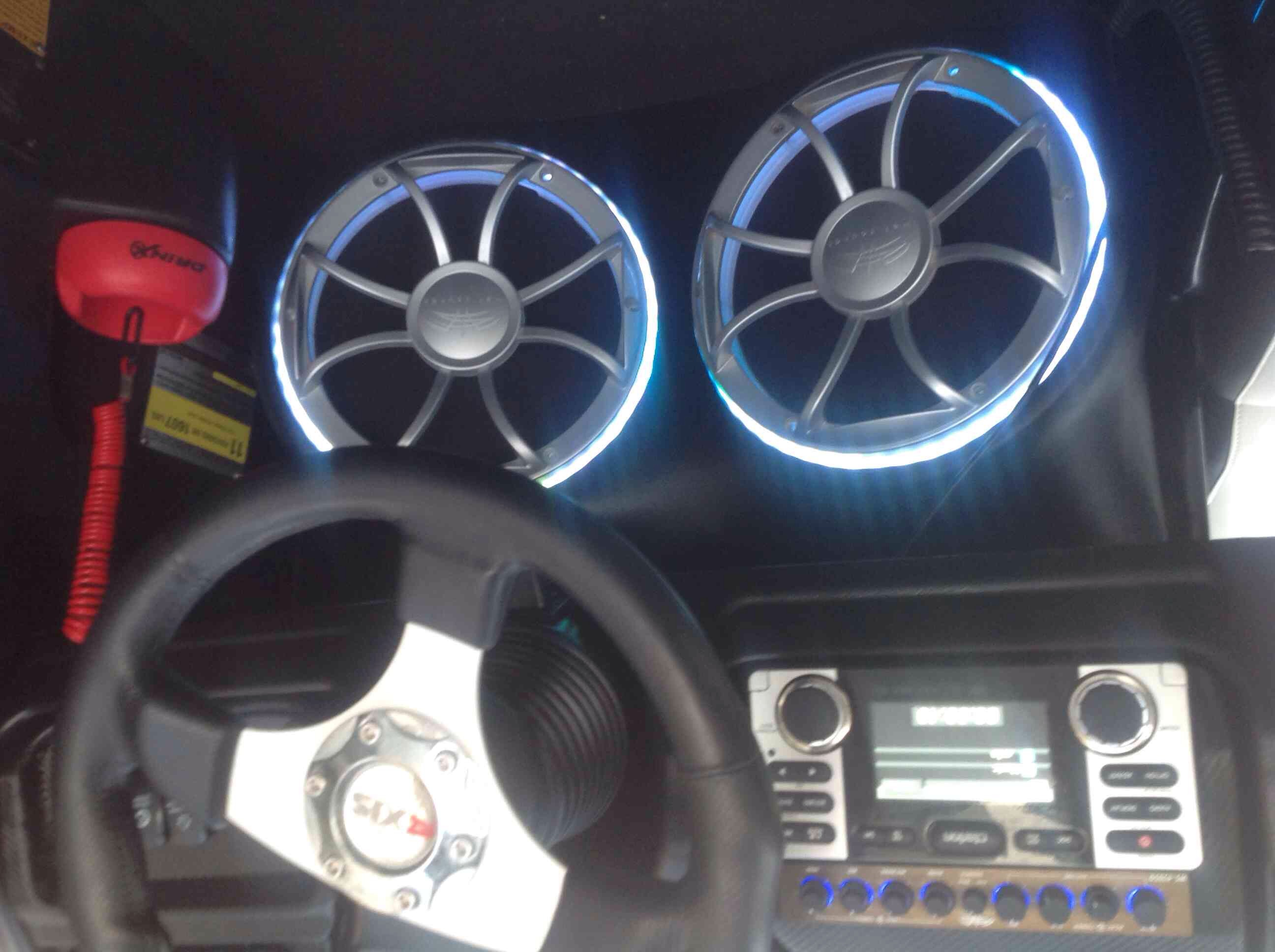

2 x SD6 amps
1 x jl 1200 amp(powers the sub only)
6 x xs 650 Rgb's in boat
4 x Rev 8's on the tower
1 x JL 12W7AE-3 subwoofer
The subwoofer is under the helm in a box(used the recommended dimensions on the JL site), couldn't go with a 13, wouldn't fit
Fabbed the false front out of fiber glass and used wetsounds 10" rings that I already had. It is attached using 2" industrial Velcro strips.
Had a 3rd sd6 mounted but it was over kill so removed it for the time being, pending my finding some more speakers to install
I wanted a double din head unit so when I made the dash piece I also included a space for the 420.
The best upgrade was the woofer, the sound is amazing.
The battery upgrade is due to being stranded once, that won't happen again!

That looks great mex! Are those 2 sub grilles just for the vent? How does that w7 sound? I had 2 13w7s in my old boat and they sounded pretty good.
 Post subject: Re: Wetsounds install pics
PostPosted: Wed Mar 26, 2014 10:30 am
Joined: Thu May 23, 2013 2:30 pm
Posts: 11
Yeah, the grills are just to vent
