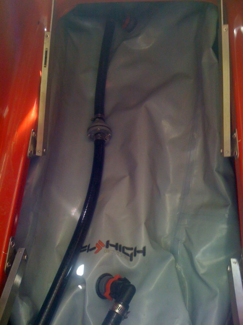

I have not experienced this but that makes sense. I just started riding behind my A22 and have all the bags full so I have not noticed that any ballast auto filling past the pumps. I did have a problem with the front pnp bag getting completely full but not overflowing out the hose. I shortened the vent line and I made some cuts into the fiberglass where the vent line goes behind the foot panel so that it was less likely to get pinched and it has been venting/overflowing since.
Does anyone know of any inline 12v electric valves that we can put in line of the fill hoses? I was thinking if i got 4 of them and wired each of them to their respective toggle switch so that it is only open when you toggle the ballast switch to "fill", then it will be closed all the rest of the time and you will not have to worry about autofilling or one way valves. is this possible?

This weekend I'm going to switch the fill and vent hose locations, since the vent hose is under the fiberglass panel, I'm going to route it to the fill port where the air pocket usually is and see if that helps with venting out the big bubble that seems to get trapped under the chillax, we'll see how it goes, here's a pic after moving the hoses, I routed the vent to the rear and under the bag so that it doesn't kink and stop working properly, i'll let you guys know how everything works out

Walter, what is the fix to stop the front Sac from slowly loosing water thru out the day? All others retain water until pumped out, but the front sac has always required 'topping off' thru out the day, as it seems to slowly drain on it's own...

a check valve just like the one you see in the above picture^ will do the trick, if your boat is an '11 model it should have one but you can try moving it from right at the pump to the top of the bag so there is less water pressure pushing back on it

Darth- mines a 2011 and has the check valve just like in walters picture. I have had no problems with my front sack. I think its $12 at wakemakers.com
