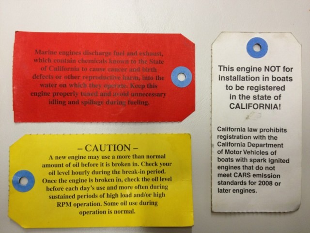

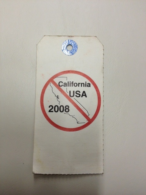

Ya if you found one without cats you may have a problem, here's the tag that was on my 2010 engine

Ya, I would assume if the boat had been sold pre 08, it would be legal to bring into CA used, but since they were produced after the law, that doesn't work. I got in contact with malibu and actually had the western product rep call and have a conversation with me. Great service and I don't even own a boat! Back to the point, he informed me that basically all 2011's outside of CA were ordered without cats to keep the prices down, which is definitely not CA legal. He said all 2012's have cats and most should be fine for CA, just double check with malibu before I purchase and they would confirm that specific boat is legal.
Walter that was what I have seen/heard anything outside of CA says no no no for CA waters. Just didn't want to end up stuck and now I have the information I was looking for. Kind of sucks as i had my eye on a 2011 in the classifieds. Oh well, still have a few more 2012's I've been eyeing that will hopefully be around in dec when I'm ready to go. Thanks for the help everyone! Really appreciate it. And a shout to malibu for the great customer service.

Posts: 6
I see what your saying, but I don't see that happening. And from the looks of those tags and from speaking with malibu, I don't think its possible but I guess I might as well give it a try should the opportunity present itself.
