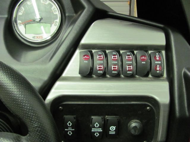

No the switch should be lit up when it's on, tha acc switch doesn't have a light on the bottom, so if it's flipped down you may not know about it, the one next to the heater switch is just a one way switch I think.

Open your chillax seats and take a look, mine had a y connection hooking the fill, drain and overflow together for the front pnp so the boat doesn't take on water, that might explain why it was coming right out as soon as you turned it on, you need to remove the y when you install the front bag, and put on the quick connectors. Elc is right about the switches, center is the factory tank, front will be the bag, the '10 models didn't come with the front switch, it just says acc, and there isn't a light on the drain side so you have to be paying attention on that one
Not true about the 10 models not having a front switch. Ours is a 10 and has the exact same switches as in the picture in the first post.
 Post subject: Re: Factory Ballast system controls
PostPosted: Tue May 10, 2011 7:35 pm
damn i guess they ran out of front switches when they built mine then, all i got was an acc switch, it still functions like the other 2 way rockers though

Posts: 69
That is odd because ours definitely has the front switch. Even our friends 09 has the front switch and it doesn't have the PnP.

Walter, I bet the factory would send you a front switch - Thats not right!
PostPosted: Fri May 13, 2011 6:41 am
Ya Matt hooked me up, he said all of them should have the front switch, mine just squeaked past the inspector somehow.
